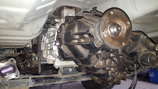

Below are pics of the Mua5H output and the DSD trans he has.

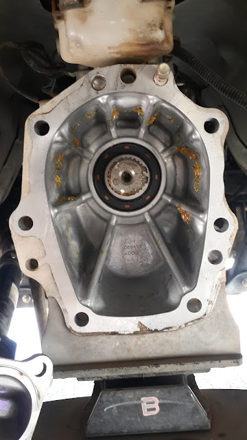

Female input on Transfer Case he has:
Rear output with the Mua5H and the DSD case:
The output is a slip shaft style and not a flange. That is very different from ours!
front input and output of the 4wd on the DSD case
Even more amazing, is that the MUA5H does not have the integrated transfer case. :!: :o :shock:
It bolts onto the back.
The MUA5 we have in the states has the integrated case in the middle and last clams of the entire Transmission! :evil:
And even more amazing was when he sent me pictures of the rear output and the case female input, I told him to go find a V6 3.2 transfer case from an automatic trans Isuzu and see if it would fit. :idea:
He told me the spline count was 27 and the pitch was the same as what I measured out for the slip shafts on the GM 4L60's.
That is the same as the Mua5 I had and the Ar5 input! :shock: :mrgreen:
Now we're talking. Isuzu was smart enough to keep a good thing going and they did it for years and years.
This sounds really promising that a PSD case would fit his diesel Mua5H transmission. :albino:

I sent some rough measurements of the female input on the stick shift transfer case i have.
Getting closer now.....
So Eric pulls an electricly shifted transfer case from a V6 Isuzu in Panama and attempts to bolt it up to his Transmission......
Looks like a 4L30 automatic, anyone confirm from the pic?
Now check out the PSD (left) and the DSD (right) cases side by side:
Well buys and girls... drum roll please......
they line up.
Amazing!
Lastly the driveshaft flange lines up too!
another good thing Isuzu never stopped doing!
Not every single bolt hole lines up but that could be solved with a skinny adapter plate and you now have soooo many more options for front axles.
