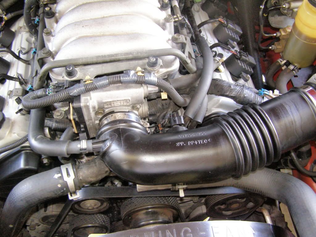

The logical way to reach the pipe seemed to be by removing the TB so that's what I did.
In this PIC I have unplugged the connectors that were in my way as well as removed the tube going to the A/Box.. This connector BTW was a bit tricky but I was careful and once figured out how to release the connector it was no biggy.. (btm R in Pic)

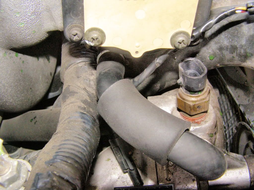

Another veiw showing that I also disconnected the temp sending unit so it would also be out of my way..
Remove the 4-10 mm bolts and the TB comes right off.. At this point I disco'd the two coolant lines and can say for sure with my rig that was the most difficult aspect of the entire little project.. Be careful removing these lines, breaking/cutting one will put you out of commission until replaced..
