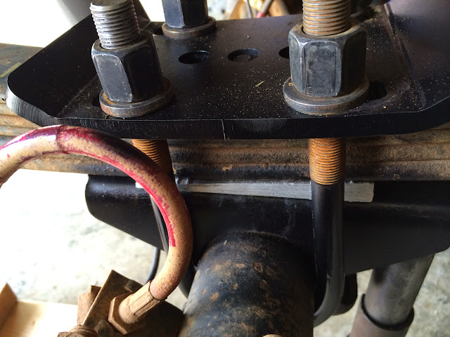

Looks like Chris and I's measurements were spot on.
The sticks come out the same spot around 24" back from the bell.
The bottom view without the case or cross member on it yet.
Slave cylinder bolt right up
Tcase is in the trunk and a new cross member needs fab'd up.
Need to get shaft made for the front, and the rear re-tubed.
Stoked!

So Chris managed to put together my spare rear two piece shaft and make a single shaft with minor changes.
Using a Toyota rear yoke and a 'washer' cut from the burn table and two new holes, the shaft was a perfect fit. Talk about dumb luck.
So if I need to make a spare I can grab a rear isuzu shaft, trash the center carrier section then go find a rear yoke on a rear Yota shaft.
We're at 39-40 degrees at full droop up front!
The cross member for the trans bracket couldn't be reused on both sides because the new position is about 5" further back and the front link has to cycle up/down.
So Chris moved it back to where the torsion bars used to bolt in and then ran a bar up to the passenger side mount: Genius! Simple is better!
Can't wait to get this on the trail.
Getting rear shaft made with thicker wall.
Got new rear shocks coming.
Going to change out shackles and bushings at some point and few minor other things.

Postby lorenzo816 » Sat Oct 25, 2014 2:39 pm
I've done a little bit of work to the truck in the past two months.
Got the right side hub 'shimmed' up with these:
http://www.ingallseng.com/26126-6-bolt- ... -shim.html
Put my tires back at a matching angle on both sides. I was extremely positive on the right like this, if it makes sense: | / now both are as close to this as I can get it: | |
Here are a few pics of the shim job.
Also put some 4 degree shims in the rear. I should go back to Chris and get him to move the perches but this will do for now.
I had to move the pinion down because the aussie in the rear was rattling when I'd coast or let off or on of the gas. Not cool.
Didn't match the output angle on the trans either. To be completely fair, I did swap trans and we had no idea at the angle that the AR5 was gonna be out at.
Also, not too long ago, I noticed that when I was on and off the brakes that I could feel a shifting up front and a clunk sound.
Turns out I busted a lower link on the driver side. Got another from Chris and swapped it out before my last wheelin trip... the one that involved a monkey, towing a CJ home, blowing my fuel pump and even a delorean. Ya no joke. Long story. :D

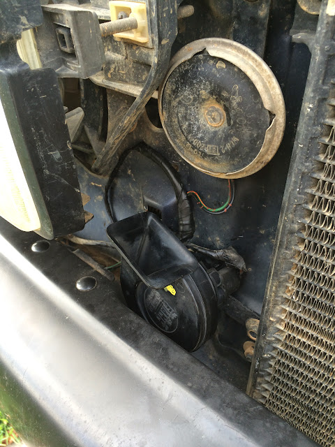

I also added a horn to my current annoying Barbie Isuzu horn. Hate how our horns sound soooo wimpy!!
I yanked this from am old 5 series BMW in the yard awhile back and just tapped the line to the current one:
I like how it sounds, kinda duotone sounding.
Its the lower one - if you can't tell.
