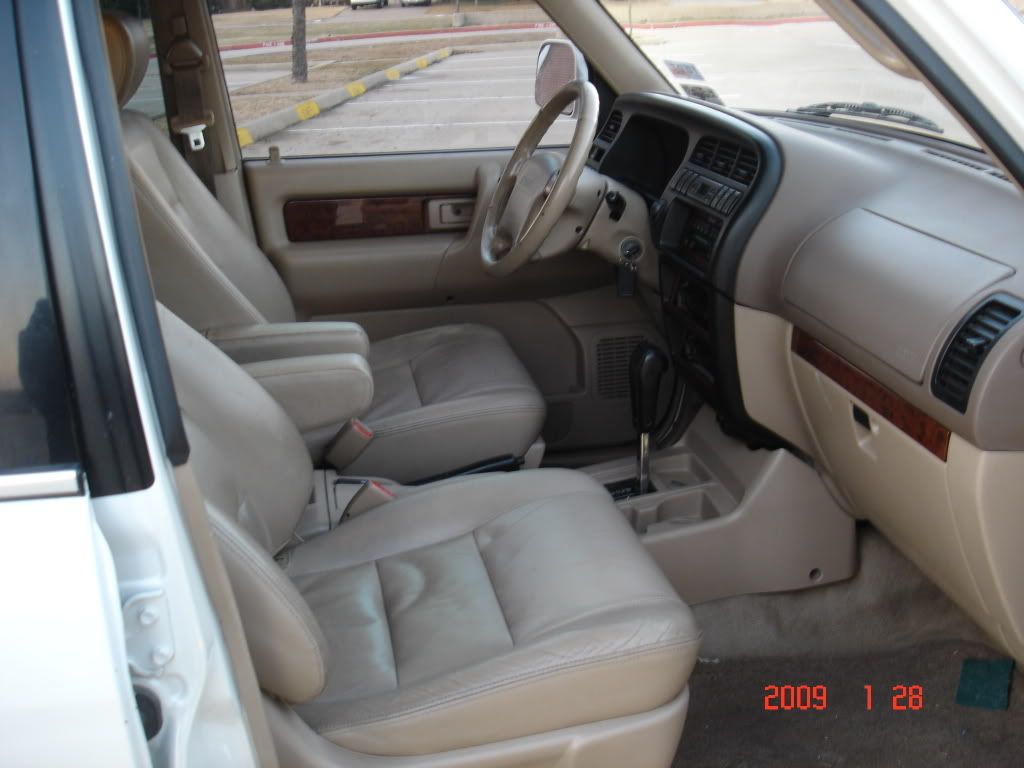

Dude, this is a sweet trooper! That interior looks downright sumptuous...

Well Its started :twisted: I swapped out with my 89 trooper and left the 01, Its been at my buddys shop. First time driving it on the road in 4 years :shock: I really need to remove the welded rear!! I pulled my 3.5 and started to swap the trim peices on the 01.
almost ready to pull
Auto trim
auto shifter plate.
test fit
Made the 30 mile drive no problem, She needs some work though!..
