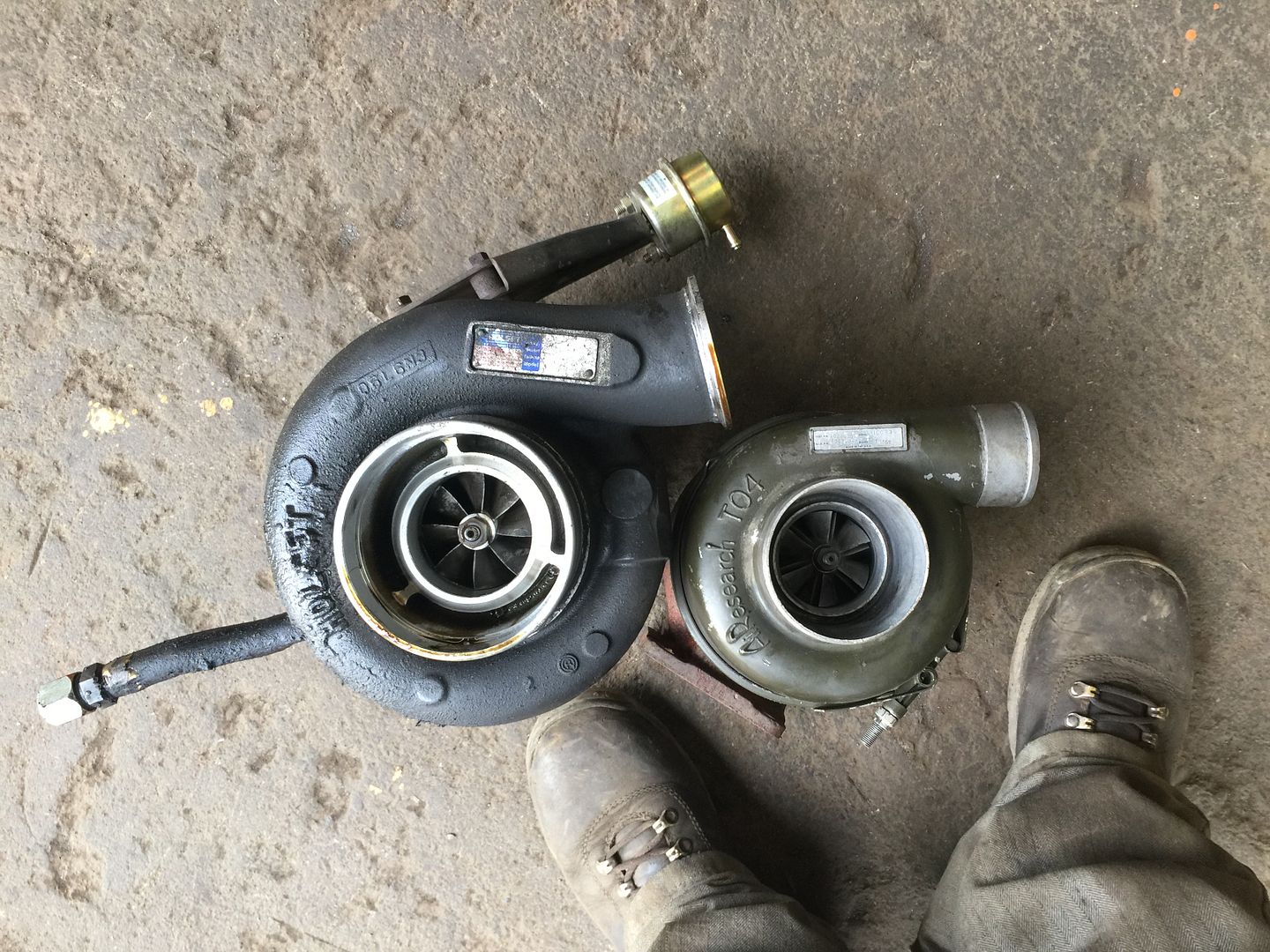

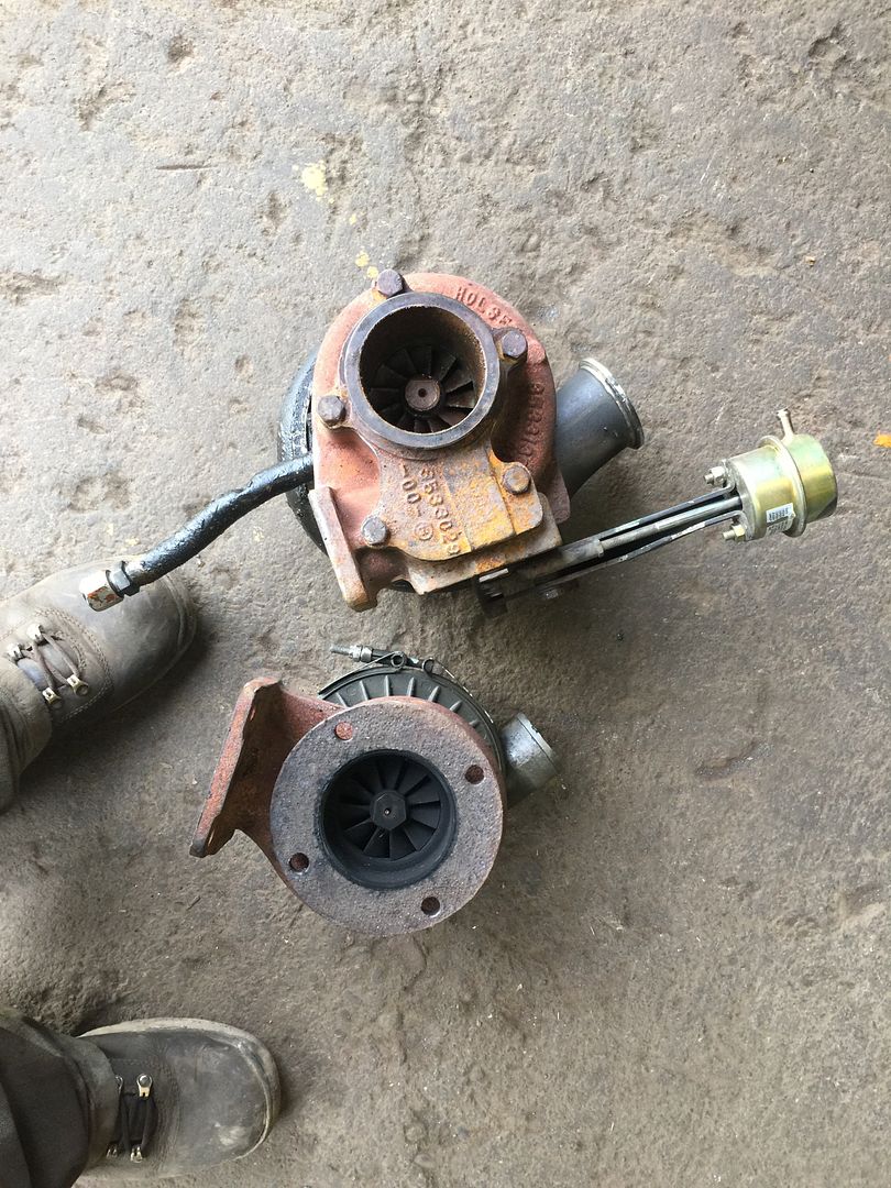

I'm thinking of revamping the turbo system , be a little cooler if it spooled at idle like the die cels and tone down the max boost , I need to see if it's in good shape ..

Probably going to need a more efficient perturbo exhaust setup. Ever though of building a twin scroll setup? You could always look into a billet wheel for the compressor as well. They decrease spool up quite a bit.

Set it up for anti-lag! Just kidding. How are you going to have it spool at idle? That's got to be the tiniest turbo ever! I'd start to worry about being in a really inefficient(and hot) zone on the compressor map at higher rpm's...
Also, what do you do for an ECM?

A huge contributor to your spool problem is the way you've designed you manifold. The crossover pipe is fine but it exits into a large void where it merges with the passenger side. This causes the gases to slow down, expand and cool. Once all that happens they have to compress and speed up to go through the turbo. You'd be much better off building a passenger manifold out of ELS fittings feeding the front port of a twin scroll while the crossover pipe feeds the rear port.
http://www.superstreetonline.com/how-to ... em-design/
That's a decent explanation of twin scroll turbos. For your truck you'd want the passenger bank feeding one port and the drivers bank feeding the other. There should be several twin scroll exhaust housing for your turbo for fairly cheap. Also you'll probably want a 12-15cm housing. You'll give up some top end but the low end gains will be worth it.
humming wrote:Set it up for anti-lag! Just kidding. How are you going to have it spool at idle? That's got to be the tiniest turbo ever! I'd start to worry about being in a really inefficient(and hot) zone on the compressor map at higher rpm's...
I hope you're not talking about the turbo Brad is currently using. That turbo is off a 5.9l Cummins diesel. On a gas engine it will support over 500hp. There's multiple people in the Japanese car world using this turbo as well as several Holsets pushing 30-40psi. Some are running 8-10,000rpm engines with these turbos. They have a reputation of being super durable and flowing more then a comparably sized Garret/Turbonetics/whatever.

Postby bradzuzu » Sun Apr 09, 2017 7:30 pm
Good discussion ... I can't say I'm disappointed in the way the engine performs or performed with the exception of the light throttle and 3-5 lbs of boost on a slight incline , it was like the pressure was there but such a light flow that the maf reading was to low ... I will no longer have to deal with the ion sensing system or the flybywire :) ... I'm also going to get an fic 8 which is designed for a frequency based maf , that in itself will be a big help !! As far as turbo spool , it would make 3 lbs starting around 1500 rpm and with a gasser that's not really bad at all ... At an idle how ever the turbo is just spinning around slowly , the internals are pretty good size and add inertia which is where the issue lies ...
Here's the two turbos sitting side by side
The smaller one is off of a 6 cylinder diesel generator I believe , its close on the impellers , I'm having both of them checked out and will see what the results will be ..
I ran that smaller one on my air cooled 2076 years ago for a couple tests and it made around 8 lbs off that engine and spoiled up at an idle ...
One of the factors I took into consideration when I built the turbo manifold was durability , that much weight bouncing around would stress a tube style manifold and crack it , I've had a couple spots crack on mine even , either related to heat cycles or to much weld ground off after building it .. I'll get some pics of it tomorrow when I get to work , it'll show how the feed from the other side links in and is directionally faced (it was the best that I could come up with) ...
The other thing about the big turbo - I changed out the vacuum pot to a 7-8 lb spring rated one after the diaphragm ruptured in the other original one (I opened it up and redid the spring tension in it to)... So even with the tension set loose I can and have hit 12 lbs around 4000 rpm and gaining , about that time the clutch slips too , I don't need quite that much torque hitting the drivetrain ... I'm going to test a different air feed style , may or may not work or help we'll see... Oh and no more ecu under the hood so more room for other options !!
