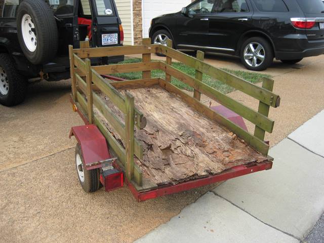

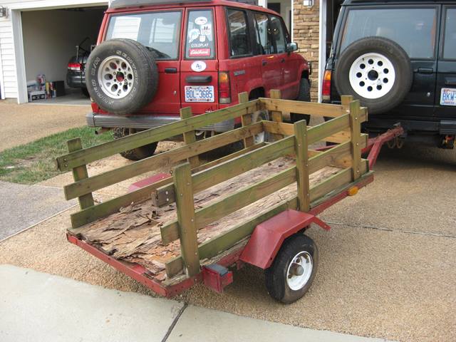

Today I got started on tearing the trailer apart. First I tore off the nasty and mostly rotted wood:
Then I separated the main frame from the hitch portion... which was done primarily so I could stand the trailer up vertically in my tiny garage:
Next was tearing off all of the electrical (which was secured by string! LOL!):
Then last but not least I got the tires removed and got the remaining rusted bolts all sprayed with PB Blaster so I can remove them all and replace them. Here's how the carcass sits now:
The frame could really use a deep sand and repaint, although I need to have it ready for a short Uwharrie trip in a week so I'm thinking I'll just get it cleaned up for now and do another tear down over the winter... I guess I'll see how fast things go.

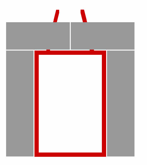

Yep, that's the plan! I intend to keep the trailer footprint as is for towing (3' x 6') then expand the platform when I reach my destination. Ultimately I'm hoping to fashion things so there is minimal effort to get it unpacked/packed, as I have limited time before I need to use it the first iteration will likely be a little more ghetto. :roll:
@ Brad - see, there you go again... asking questions like I'll actually know the answer! LOL!! Seriously, though, it's straight unless I'm mistaken:
If I do end up wanting or needing more clearance it looks like it would be easy to whip up a smaller version of the "ChrisBilt" shackles... which actually might be nice, right now it rides pretty low and with the back tire on the Trooper I basically can't see it at all while in tow.

More deconstruction this afternoon, despite the fact that I had soaked everything with PB Blaster it took forever to break through all the rust bolts... I have a feeling I'll be making a trip to the farm supply store so I can buy replacement hardware by the pound, almost everything I took off will need to be replaced:
The whole front end, leaves and axle are off and washed, with the exception of the fenders the main frame is stripped and ready to wash as well - it's going to be hard to resist the temptation to sand and paint!!
@ Dennis - yes, I watched a couple videos this morning and plan to do an overhaul of the bearings while everything is disassembled:
One side spins really smooth, the other is sort of gritty so guess I'll see what's inside and replace things if necessary.

Now since you have a flat bottom tent(guessing) you need to fold out and then in for all 4 pcs to be flat.
The inner part needs more support because that's were the butts...ooopppsss hips are and more wt in 1 spot
So...maybe fold out the "ends and then set a pc of plywood with a "wall" attatched to the bottom,into the trailers original dimensions (kinda like a "t")
Dunno....
Just ideas....a couple pcs of emt would support the fold out pcs to the frame at an angle
