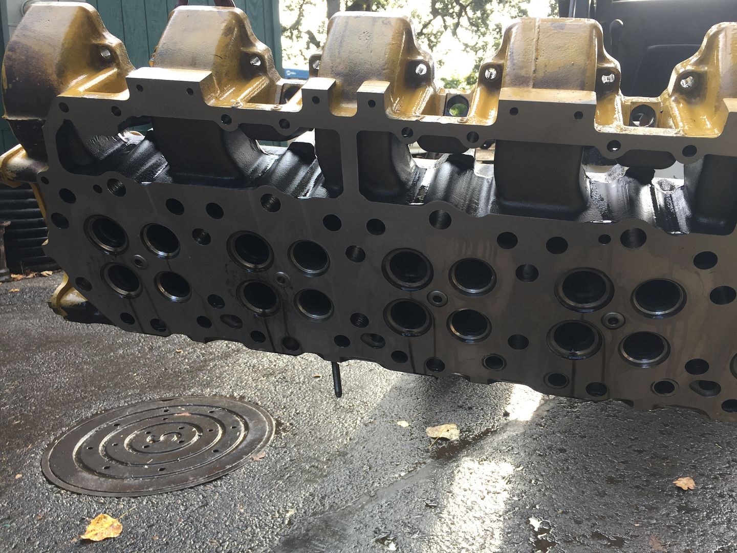

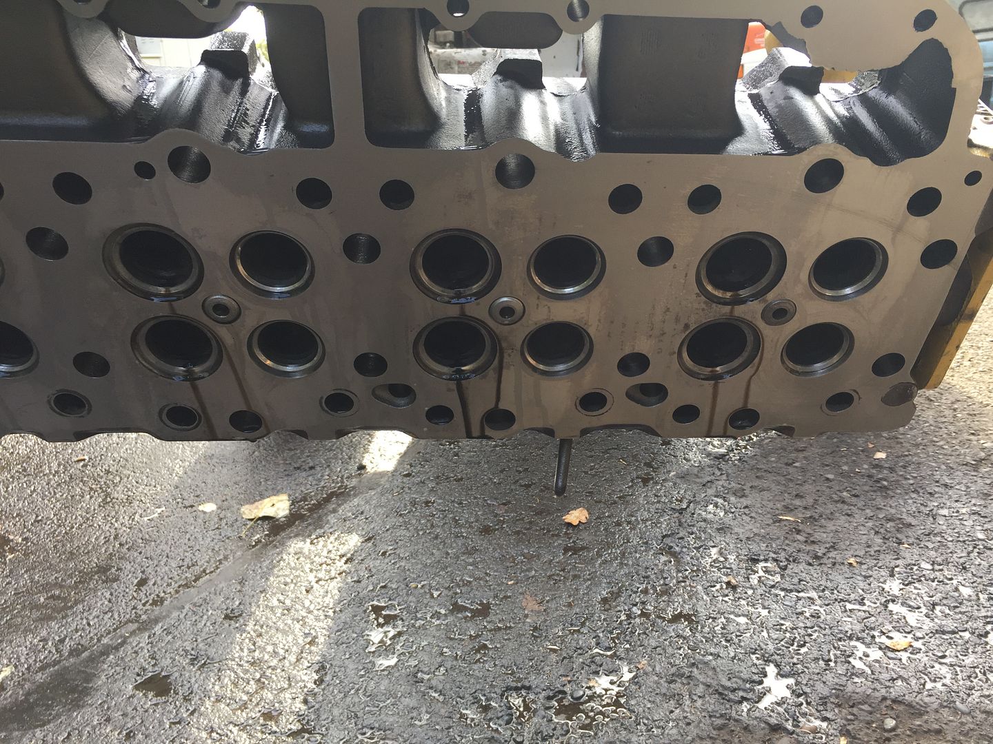

Postby bradzuzu » Tue Nov 15, 2016 1:24 am
If you look back up in the previous pictures you'll notice the head sitting all packaged up under the front of the truck , it sat there for a week while I finished up the engine and dropped it in ...
Here's the head after the third time of taking it down to get it worked on ... So little did I know that while it was sitting there it was corroding up .. I pulled it out of the wrapping and first off noticed it was still dirty , as I was cleaning it up I went to blow air down the intake ports and when I got to number three cylinder water came boiling back out , at that point I stopped cleaning and lifted it up onto its side , To my surprise (not) all could see was rusted spots where water leaked past all of the valves and soaked the cardboard that it was sitting on so the head got all rusted up too... I loaded it up and took it down to the shop that just supposedly rebuilt it ... To back up to the begging , I dropped the head off and the guy called me asking what all I wanted done , at first he tried to sell me a remand head for $1100 , I mentioned that the truck was running fine and it would be worth pulling a few valves and checking the guides and stuff ... Easy enough right , well he called back and said in his surprise that it looked great , I kinda figured and hoped that would be the case...
Cost was $450 , surfaced , vacuum test , I figured a quick cleaning and such ... Now back to finding the water and rusted mess , I dropped it off and talked to one of the guys , there excuse ?? Lack of communication between whomever , I was not happy ... next day they called and said it was ready to pick up ... brought it back , opened it up to see that the buffed the rust off , I pulled an intake valve because I was very skeptical of there work at this point , port and valve looked filthy , I pulled an exhaust spring and retainer but when I pushed on the valve it was stuck (seized from rust) didn't take much to break it loose but I could see faint rust streaks and water sign "still!!" ... I called them again and threw it back together and loaded it up , I took it back down even though it was late in the day , the guy promised he would stand over the guys shoulder and watch him pull each valve out and clean them ... I was so irritated , frustrated , pissed off and offended that I just left ... This has taken up almost a whole weeks worth of time now , can you guess what happened the next day :)

Re: The heavy part of my job ....
Postby bradzuzu » Tue Nov 15, 2016 1:49 am
Next day !!
Yes they called , again,,, and said to my disbelief that it was ready to go ... After getting it back to the shop I immediately hoisted it up onto it's side and began pulling a few valves , they still looked like crap ... I was so done waisting my time with the place so I just went down to my auto parts place and let home look at the valves real quick , instead of looking at them he tossed them into the valve grinder , didn't take much but now I was committed !! I ran up and quickly pulled the rest of the valves to get ground , in my opinion they did need it and with a brand new bottom end it would be foolish not to have a brand new top end ... As he was running the valves through he stops and says "oh bent valve" , it was an exhaust valve ...
He found one more bent exhaust valve , had to of come from number two cylinder since that's the one that let loose and the piston kissed them ( I mentioned that to the rebuild place , didn't get me much though did it), I ordered two new ones and picked them up the following morning ...
Back to the cleaning part , mind you this is after the rebuild place had my head in there shop three fricken times !!
I no sooner squirted degreaser into the ports and black ooz stared coming out , I had to steam clean the head at two different angles just to get it washed but finally I had a nice clean ready to assemble head ... I also lapped all the valves into the seats , no point in just re grinding the valves and not doing the other half ...

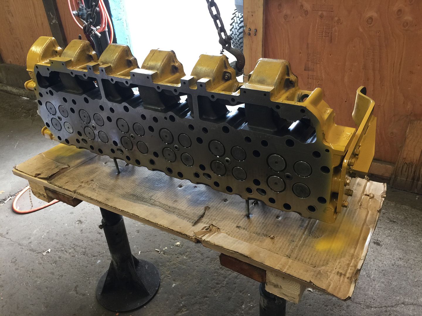

Postby bradzuzu » Tue Nov 15, 2016 1:58 am
In the process
Sitting on the block finally
Going through the steps to get the headbolts put in and torqued
The stack up and Jake brake installation
Finally an engine with valve covers !!
And intake
Like most engines this is as good as it gets because from here on out you start covering up all the pretty painted up parts
